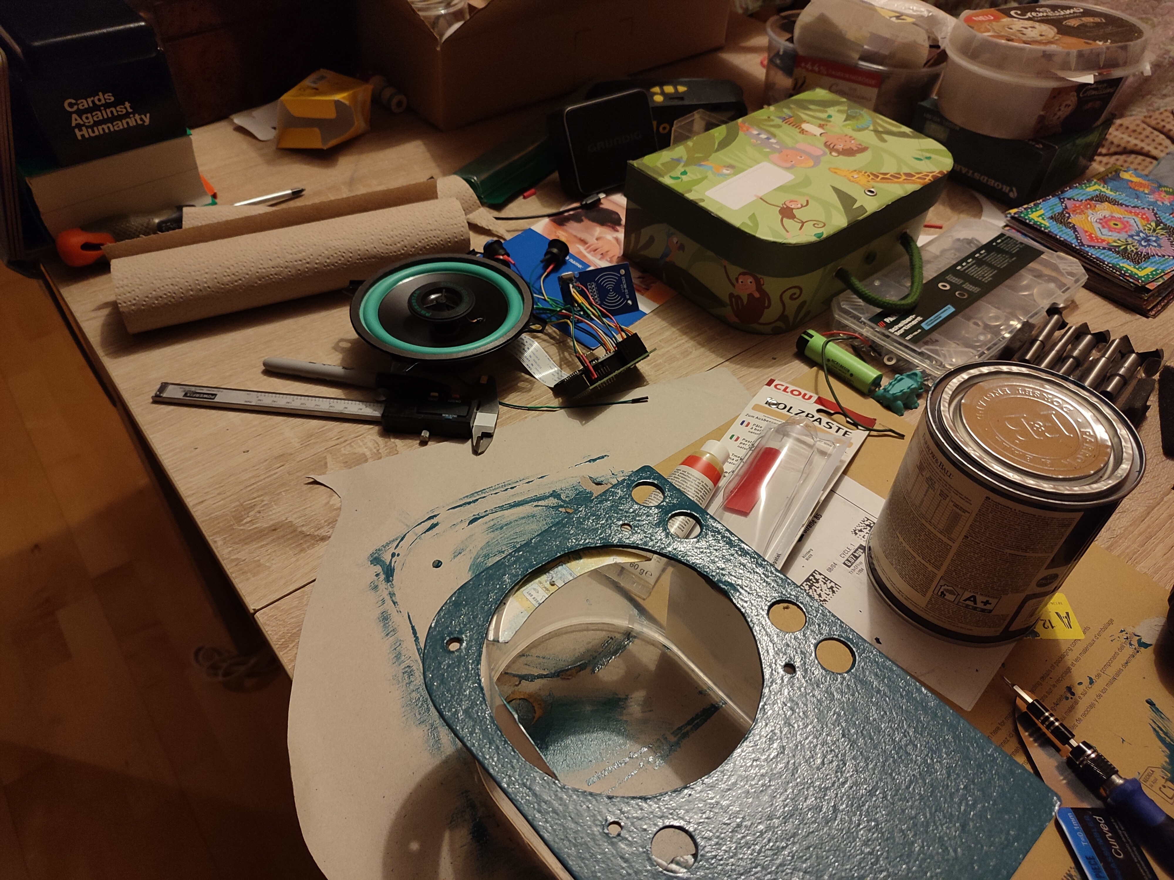

Well it’s looked like this for the past week, but the boost board arrived this morning so we were finally able to put it together!
The glue is curing under a heavy weight right now :grinning_face_with_smiling_eyes: (a German-English dictionary, but I’m only allowed to post one image apparently)
I’ll try programming a tag with it once the battery is done charging.
