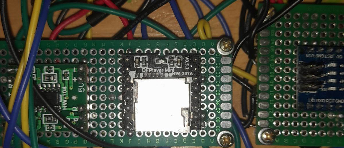

Hi, I built a TonUINO using an Arduino Nano. It boots, beeps, enters the admin menu, writes and plays cards. But it only plays the first and second songs (001.mp3 and 002.mp3) of each directory. Initially it only played the first song, when using a 32GB flash drive, but switching to a SD card (tried both FAT32 and FAT16) it began playing two songs per directory. Even if the three songs are all a copy of the same file only the first two play. And a minor problem is that the next/previous buttons do not change to the next/previous song, but they do work in the admin menu.

To the left of the DFPlayer I have a PAM8043 amplifier, the input comes from the DAC_L and DAC_R pins of the DFPlayer. That’s to have stereo audio as I use two small speakers.

There is a DF-Player clone that uses a chipset that is extremly buggy, an causes your described behavior.
Unfortunatly by now there is no other way to replace that DF-Player.
From the printing on the upper side of your player shown in your uploaded photo, i asume you unfortunatly got one of those. On the bottomside of your player, you will probably find a chip with „TD5580A“ printed onto it.
